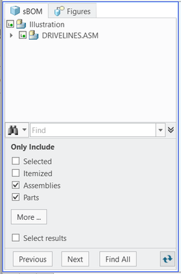

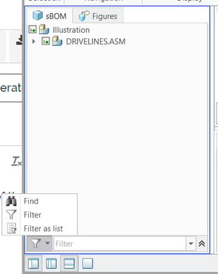

The find has moved to the bottom of the sBOM/eBOM panels in 10.0 and as such is always available.
For more details see: New Combined Filter & Find for sBOM/eBOM (ptc.com)
We are looking into hooking Ctrl+F up to switch focus to the Find/Filter input box in a feature release.
Let us know what you think of the new Find/Filter capabilities.
