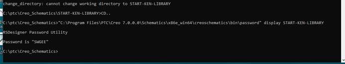

I tried this command to make password protected,
but i faced following  error
" RSDesigner Password Utility
change_directory: cannot change working directory to C:\Users\Public\Documents\Creo "
but the default location of saving the design in Creo schematic is same as above i.e " C:\Users\Public\Documents\Creo ".
Changing this default location does it work ?
I literally tried changing the design locations by moving designs but couldn't achieve in setting the password successfully.
or please let me know if there is a specific location where the designs should be saved.
like in " C:\Program Files\PTC\Creo 10.0.0.0\????? "
From my own notes on doing this process;
How to set a schematics design password:
Save as the design into a folder (network drive or local drive). In File explorer navigate to the location you saved design (not the folder of the design name) Open the command window (type cmd in the microsoft search window) Change to the directory that you saved the design to (not the actual design name, the level down) Copy/paste “C:\Program Files\PTC\Creo 7.0.0.0\Schematics\x86e_win64\creoschematics\bin\password” (add the quotes “”) upload_-aW1hZ2UwMDIuanBn-2650818346544108241..jpg Add the word display and the design name as shown (for displaying password name).
To set the password you use set <design name> <password>

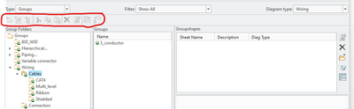

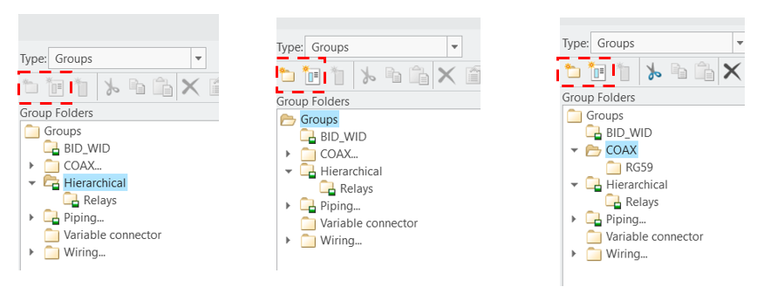

After i given a password to the template file, i can able to edit the artifacts by unlocking with password but why cant i create a new folder in the groups blocks etc. as highlighted below?? kindly suggest.

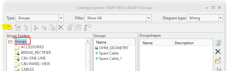

Hi PKUMARAK,
To create a new folder you must select the top level folder first. In your example, select folder “Groups” like this screen shot;
Then you will get the option to create a new subfolder (first icon on left).

Yes you are right it will allow me to create folder under groups, also under the folder which are not submitted to central catalogue location.
but its not allowing me to create new folder under the submitted folder as you can see below first image.
How can i unlock that folder so i can create new folder in that folder itself.
Hi PKUMARAK,
I think there is a requirement that the folders names must be uppercase names for it to create the subfolders. I could be wrong but think that is required since all of ours are uppercased names.
