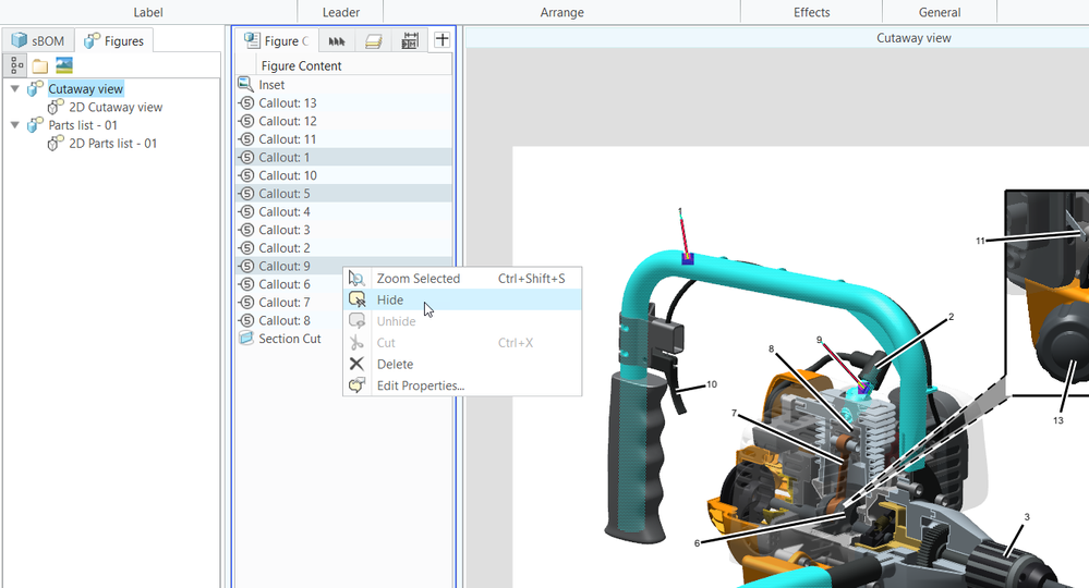

Is there a way to control visibility of callouts and notes in Creo Illustrate 7.0?
All figure content including callouts and notes are listed in the figure content tab of the upper data panel.
Right clicking on any item will give you a menu with options to show/hide/delete etc.
4 REPLIES 4

Yes, hiding a callout or unhiding while record content is active will add a visibility track to the timeline.
