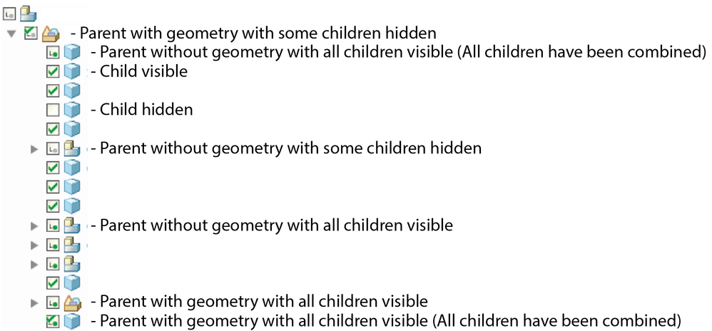

In Creo Illustrate 6.0 I can see four different checkbox icons in sBOM - see the image below. All parts are enabled in the BOM. I cannot find explanation for them anywhere. Could you explain what do that four icons mean, please?

Hi Marcin,
Here's a breakdown of the sBOM checkboxes.

Hi Marcin,

Hope this helps.
This is absolutely brilliant, thank you!
