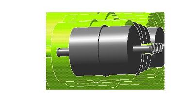

Every model I open has this same distortion. I have uninstalled and reinstalled and still have this issue. This issue occurs on even the smallest file sized models.  Any help would be greatly appreciated!
when i first open the model everything is fine until i drag the mouse courser over the model.

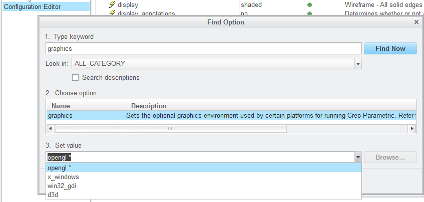

You might also have some luck changing to the win32_gdi setting in config.pro.
Not an elegant solution but it may get you down the road a bit until this is figured out.

using the environment variable- PV_ENABLE_FRAMEBUFFER_OBJECT=1 did not seem to help the tracing and distortion.
i have solved the issue by disabling openGL.
i did this through system environment variables.
the graphic quality is slightly degraded but barley noticeable
i no longer have the tracing and distortion.
  •   PV_DISABLE_PBUFFER=true
  •   PV_DISABLE_MULTISAMPLE=true
  •   PV_DISABLE_SHADOW=true
  •   PV_DISABLE_MULTI_DRAW_ARRAYS=true
  •   PV_DISABLE_FRAMEBUFFER_OBJECT=true
  •   PV_DISABLE_VERTEX_BUFFER_OBJECT=true
