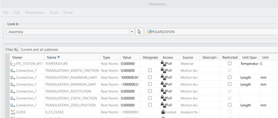

In Relation we can access to some parameters of Mechanism features like friction in Connection (see pictures)
but not for Cams, 3D Contact, Gears & Belt parameters, is there a work around?

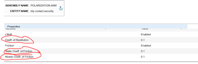

It is partialy answer to the expectation, But not for cams parameters or Belt or 3D contact.

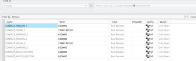

As an example here is the parameter for Cam we would like to get access:
I have cross check again i n Creo.
For Belt and 3D contact the parameters are accessible.
It miss only the parameters for CAM and Gears
