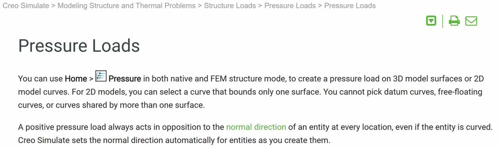

Based upon the Help Center, it is not possible to produce a distribution other than normal to the surface.

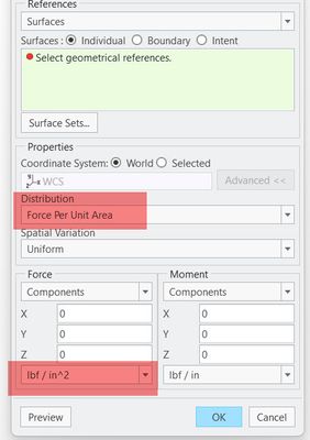

Thanks for the file.  However, that did not address what I was attempting, but close.  I am looking for pressure not force.  I tried the interpolation technique for pressure, but the pressure is still normal to the surface.  It will work for force.  The below image shows force vs pressure when using the same interpolation technique.  I am attempting this for a project, and I saw that it can be done in ANSYS, for pressure.  I have not tried it using (fx).  In the image of two cylinders, I am trying to get the pressure distribution to look like the force distribution.  The image on the left can be obtained by just splitting the surface and interpolation is not needed.

You can apply a pressure as a "Force Per Unit Area" in one direction, and it will display the arrows in one direction as shown in the previous post image "FORCE = Load 1".  This is now a pressure....right?

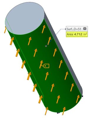

When you apply the load or look at the preview, all the arrows act in one direction, not normal to the curved surface.

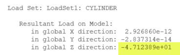

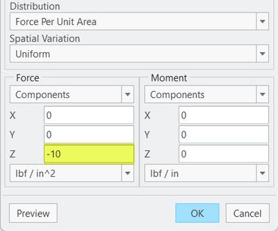

I built a test model to see what really is the load that is entered.  I entered a negative 10 (negative z direction) over the area of 4.712 in^2.  The resultant load is 47.12 lb.  This means that the value entered for "force" is actually psi.  The load arrows appear to act in one direction over the curved surface area, or this is a misrepresentation of the load direction.  Is it possible that the software is reading the 4.712 in^2 as flat when it is actually curved?
Area on half of cylinderArea on half of cylinder
