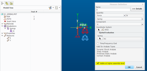

Hello, I've been working with it for a long time and now I'm annoyed by creating measures for each ground spring. This is our technique of creating boundary conditions using spring to ground and we need to create a set of measures for each one of them( X Y Z reactions and amplitude of force ). Is there any possibility to automatically create any set of measures for springs?
I know that all contact interfaces does this but not springs.

my suggestion is attached
Ok, just tell me if i understood correctly.
There is separate model which consists of point, spring and measures. You placed it somewhere on model (in your case coinsident with vertex). And it created a mesh with this point in mind and this point is now connected to the created mesh. Is is so? I've never used this technique.
If so that wouldn't work in all cases i'm planning to use it, but very effective method of for this purpose.

yes
There is a possibility to standardize such elements.

I meant: Creo Simulate supports hierarchical FE models,
so FE features can be collected as parts in a library, e.g. springs to base with different directional components and corresponding measurement quantities, ball bearings, roller bearings, as parts and also as assemblies, etc.
Similar to standard parts in Creo Parametric.
