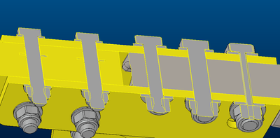

Hello, how can I replace in simulation those kind of bolted joints so preload is included. I need to create linear simulation with bolted joints and analyse those joints so they are accurately represented.
The problem is Creo simulate can't create bolted joint while there are more than two parts bolted togeather. Can those bolted joints be recreated as a  beam structure or any kind of spring structure?

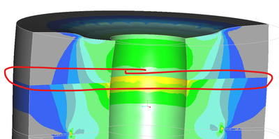

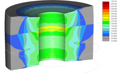

Here is a test with a volume region (aluminium)
Thank you so much for your response but if i look at the results there are too many unknown stuff is going on for me.
For example:
  • Stress distribution inside of a model

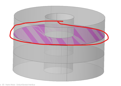

  • Discontinuity in bonded interface
    how does not bonded interface transfer everything?!
    I do like this trick using one part replacing multiple by adding volume region. But there are too many unknown stuff happening inside.
    Also numbers are correct. Contact force in both interfaces are exactly the same as a bolt pretension but for some reason stress distribution is very strange
