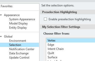

We are doing trivially simple analyses in Creo 9.0 Simulate (Not Simulate Live...) and we are consistently crashing the computers.  (Problems taken from or similar to exercises in an SDC textbook.)  See the attached for the specifications on these computers.  I have some students that know a lot about using FEA and they are not having any more success with the classroom computers.
What might I (the instructor) try, to stop these crashes?  Do we need to upgrade our computers?  I suspect this is true.  However, are there things we could change/try on these computers that would help?  (See the attached pictures, which I believe have sufficient information for people to comment.)

There are a couple things that can be tried, but generally NVIDIA GPU is what works.
However I have used CREO with even just Intel Integrated graphics with some tweaks like this.
1. Turn off preselection highlighting.
2.  Add these to your configuration file.  If it solves the crashes, maybe some can be turned on for better experience. (You can also get to most of these in the configuration menu).

You can also test Creo not using OpenGL.
Add following option at the end of config.pro in Notepad and start Creo.
graphics  win32_gdi
Martin Hanák
We did try this but the because Creo Parametric 9.0 is not approved on AMD GPUs, we were still crashing the Creo software.  A switch to computers with Nvidia GPUs instantly solved this issue!
