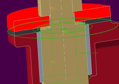

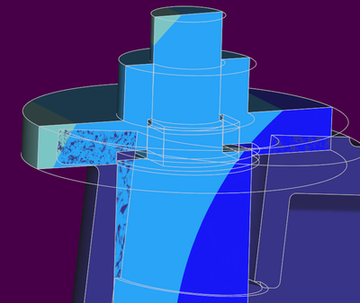

The contact pairs are well defined surface to surface and they do not have interpenetrations. Here are images the best I can without too much model detail.
Image with multiple interfaces failing:
Image of the definition of those interfaces:
It is worth reiterating that the issue is random. Sometimes these interfaces work correctly and other ones fail instead, so I don't see how it could be a problem with interface definition.

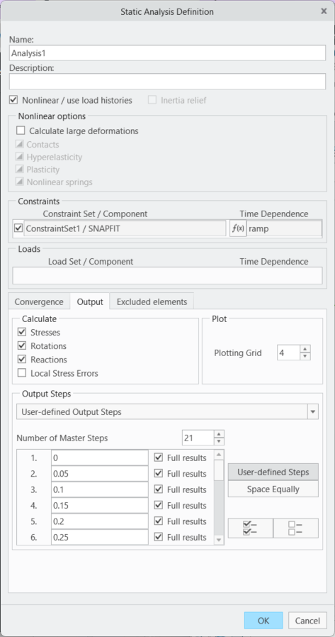

Hi Todd, I have tried defining steps of a few different sizes now and it has not been successful. The issue persists. Interestingly, now I can see that the interfaces only break after around step 0.2

Hi DK_9562724,
There is a rattlesnake in there someplace.  Without seeing the geometry, we can't help much further to troubleshoot.  Other ideas are to increase the number of elements in the contact area., look for geometry checks in these troubled areas, step geom out and back in (don't like this option, but it sometimes works), degrees of freedom are not making sense to the solver, part accuracies are far different from each other which are in contact, etc... If you can simplify the problem and share, then we can look deeper.
