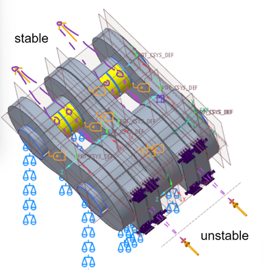

Dear Sir/Madam,
I've been trying to simulate the behavior of a hub_chain with multiple contacts for more than two months and haven't been able to get good results. I would like to know how a contact_simulation is possible with the software and which criteria have to be considered. I have already created several costing models, including some: Symmetry_Constraints. The chain consists of two pins and eight links.

Do you have a STEP model for this?
I would halve or quarter the geometry (symmetry).

Thank you very much for your feedback. I hereby send the drawing. I'm sure I used all the boundary conditions but it still doesn't work. I either get an error message like "Excessive displacement or load factor changes"

Maybe I didn't define the interface well? is there a way to use Ferder boundary conditions in this case?

Here is an image of the drawing with the boundary conditions. Unfortunately I can't load the model here because it's too big

Half model -> half load
Quarter Model -> Quarter Load
Is the load possibly too high?
I would build a small model for it.

I also tried this with a small model and it really didn't work out well, so I thought maybe I'd try it again with different models. Can you please show me a simulation example (with a press fit in the model?) or which boundary conditions would you like to recommend?

a small example attached

Thank you very much for the example, why did you define a point there ? what is its function there ?
In my small example, the load is balanced in the tension direction, but a formal boundary condition or spring-to-base must intercept this direction. Furthermore, the chain links could move on the pin, this is also prevented by the point RB as well as this small transverse force that holds all chain links together.

I used your reasoning to apply it to my Modell whose "Interference fit" is as shown in the attached figure but i got nothing as a result. Do you have an example with such a case ? Thanks a lot 🙂

please check contact pressure
Better to pull than to push. --> Besser ziehen als drücken. (google translate)
I tried that too and it didn't work 😞
