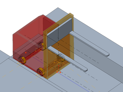

Greetings and salutions,
I have a mechanism which you can see in attachment. And when I do a dynamics analysis with movement. It will show me that force required to move and object which weight around 1500kg requires a force of 2 bilions Newtons.
I am quite lost where is a problem exactly. If someone could help it would be greatly appreciated.
You might be seeing a very high force because you've set your servo velocity to a constant speed. This means the solver is assuming that at time zero, your weight must already be moving at 250 mm/sec - this would require a very high acceleration to begin the analysis. You should apply a ramp or sine function servo speed so that you begin the servo's movement with zero velocity and increase it to your 250 mm/sec as a final speed for a time required to achieve the distance you wish to lift your forks. As SweetPeasHub already suggested - take a look at your acceleration (and velocity) and see what it is the solver used for "F=m*a".

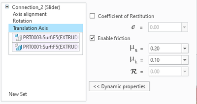

So for example i wish to simulate force required for forklift to lift its forks,
I am using slider connection with shown dynamics properties.
I set a servo motor with constant velocity of 250 mm/sec.
And when I after dynamics analysis where I use both friction and gravity.

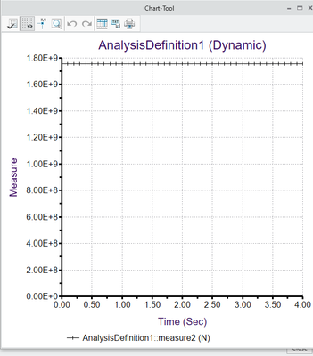

Net load for this connection is shown as this:
And if I try to simulate it with force motor I really need to use this force for it to move with set speed.
But why is that force such massive ? Analysis for my forks will show that they weight MASS = 1.8257271e+02 KILOGRAM
I am honestly quite confused. And others mechanism have same problem. Am I doing somewhere some kind of mistake ?
