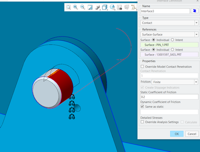

For Pin connection:

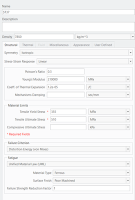

Material:
Analysis type:

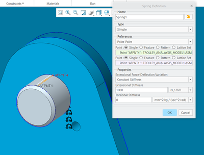

I basically do not use finite friction.
For "flying" parts like pins I use springs to base.
Would you like to have an example?

Yes please can you please provide detailed approach, how should i go about all contacts for pin? I have added frictional contact on pin diameter and hole surface. and spring for axial movement to restrict.
Also, should any changes done on config file for simulate to use?

Is it possible the material properties should be Elasto-plastic instead of Linear for S355?
Can you please suggest when "Calculate large deformation" option should be used? In my assembly, Fastners with preload is also there, Which i can't use with large deformation. Can you please suggest if there is any alternative to use with fasteners?
