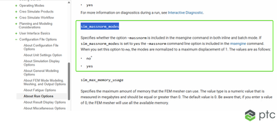

Hi Creo Team,
While performing Dynamic Time analysis should the mass normalization parameter  sim_massnorm_modes in Config.pro be set to 'Yes' or does the Dynamic Time analysis automatically sets the parameter to 'Yes' when running.

By chance did you already go through the Help Center ?
Here is the description of the option : https://support.ptc.com/help/creo/creo_pma/r12/usascii//index.html#page/simulate/simulate/run_options.html

Thank you, I had gone through this document earlier, Am I right in assuming that the sim_massnorm_modes parameter controls both Modal & Dynamic Analysis runs.

Hi i'm recommend you file a case for confirmation.
