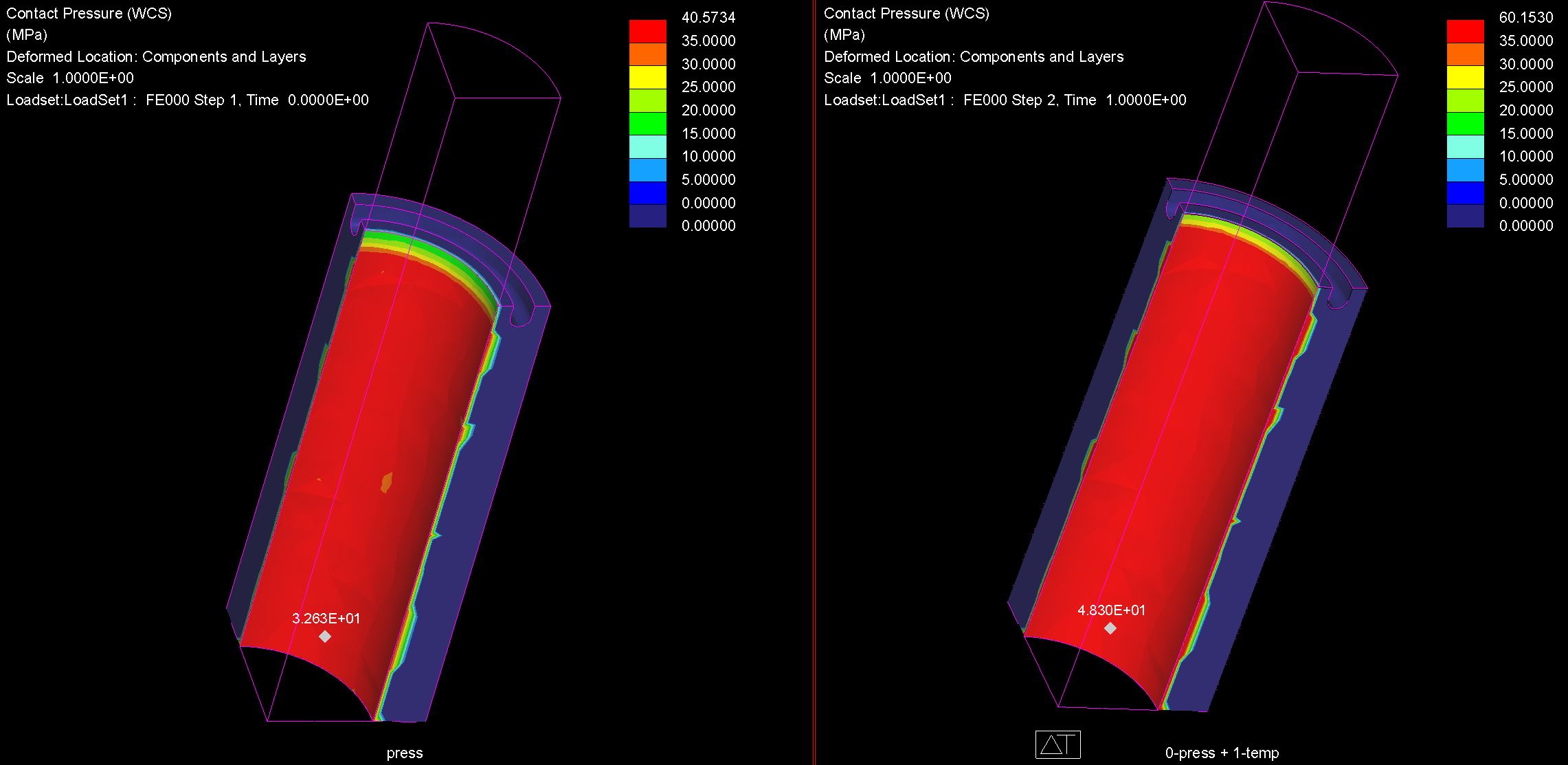

Let's say I wanted to see what happened to these contact stresses if the assembly was cooled to -40C after being pressed in at room temperature.  How would I run that?  TIA
skunks
(To:RCorley)
RCorley
(To:skunks)
Thanks skunks...It's very helpful to have an example like this.
