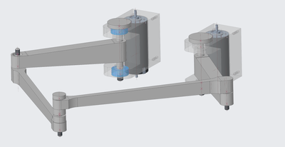

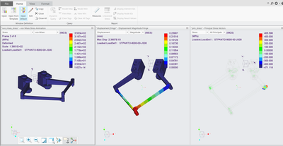

I am currently trying to apply a force on an assembly, a delta robot, more precisely on its end-effector. The problem is that the stress/force is not passing through the different parts. It is like if the static analysis is only considering the part I applied the force on.
I have simplified this first analysis by bounding some parts, the one that are screwed together.

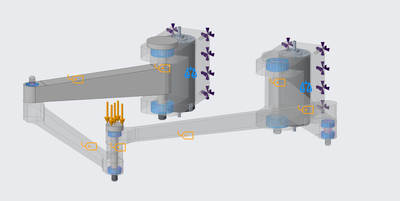

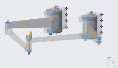

I have also not included the bearings for all joints, the idea was to link the parts without the bearings. For that, I have used the "Function Pin" of the constraints. The first joints of the delta robot are blocked axially and radially, then, all other joints are just blocked axially.
This method works on Catia V5.
Attached to this post:
creo-study1-1 and creo-study1-2 : show the result of this wrong analysis.
creo-study1-3 : shows the way I have constraint the joints, which have 2 bearings.
catia-study1-1 : this is the analysis on Catia V5

It appears to me that you are not setting up your constraints correctly. You should not have displacement constraints on the joints. If you need to release degrees of freedom at the joints I would suggest using beams to connect your joints and then releasing whatever degrees of freedom you want with the beam ends.
UniMaker1-VisitorAuthor
October 15, 2021
In the Beam definition, I cannot define all the surfaces that would interact through the bearing. How would you do it.
In Catia, I have never included the bearing, a connection was defined manually, and I was then specifying that this connection is a rigid virtual connection (with the rotation unlocked). Then, only the created parts were deforming.
regards,
Chris3
October 15, 2021
You create a point and then create a rigid link (RBE2) from the point to the surfaces you want. You do this on two ends. Then you create a beam element that connects to the points and release the degrees of freedom of the beams as needed. Keep in mind that the X beam vector is along the axis of your beam.
