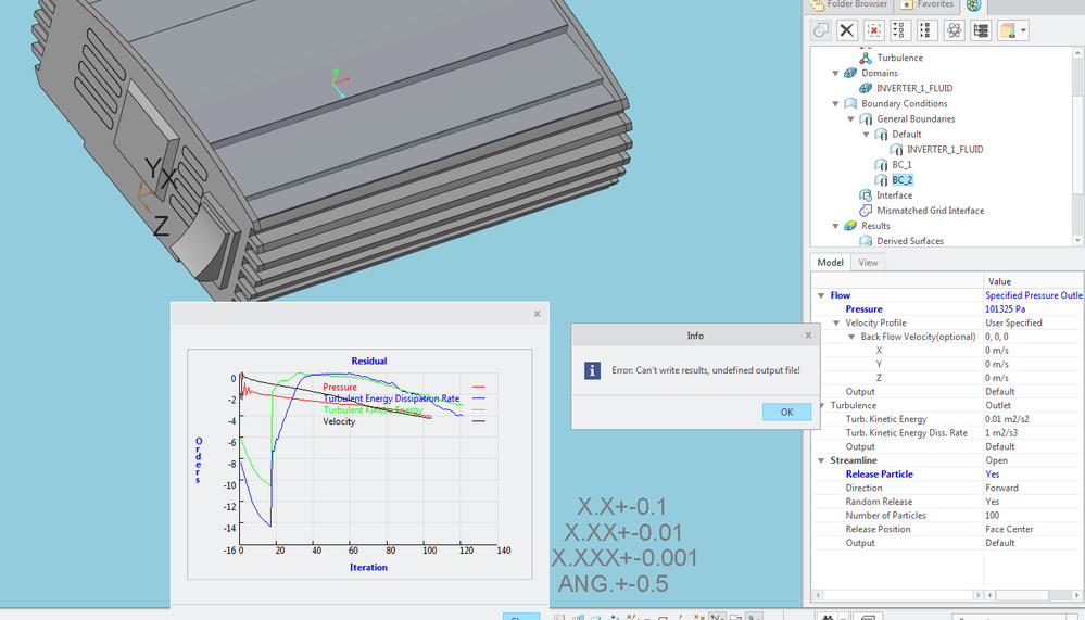

QQ图片20181219113822.pngHI,
I'm new here, this is a simple example,Detailed setup as blow, the mesh genrationQQ图片20181219124105.png the inflow boundary condition is 0.3m/sQQ图片20181219122950.png  and the outflow boundary condition isQQ图片20181219123414.pngand click Run icon, For a little while ,the soft pop up the dialogue box,QQ图片20181219124908.pngWhat am I supposed to do?  I'll uploap the files,Creo 4.0.Thanks in advance!

I had to solve the same error yesterday. It was caused by NON-ASCII characters at the path to the working directory.
It seems, that Creo CFD module doesn’t support “Unicode” fully.
