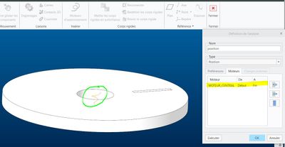

I try to to analyse gears using the mecanism application in creo 7.0.5.0.
When i creating angular motor, this one is greyed out in the mecanism tree:
As the consequence, motor can't be used in the analysis :
(However when i create linear motor, this one can be retrieve in the analysis definition)
Does the problem come from a license that we don't have for angular motors ?

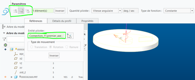

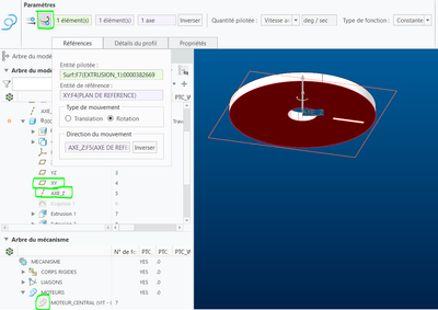

After redoing motor settings a few times, in different ways, I found where the problem came from. In fact I didn't use the "connection" between my frame and my part to be rotated.
As can be seen from the screenshots the wrong way (axis+surface+plan) :
and the correct one by selecting the "connection_11" :
this as an effect of being able to select the motor in the analysis

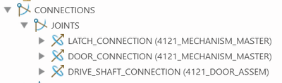

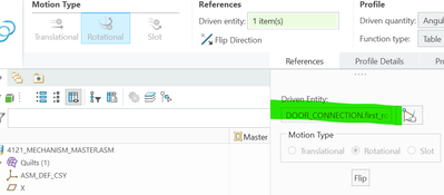

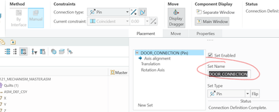

Good to hear. I also have another little tip regarding "connection_11"  The connection can be named when it is created and makes the mechanism much clearer.
