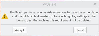

I'm starting to use the mechanisms with Creo and would like to play a kinematics with a bevel gear (or conical pair , I do not know the translation of "coppia conica" in italian), similar to the one in the video I've linked (they're only 3mb).
The assembly is very simple, it is composed of:
A)a fixed body (the vertical shaft to which the first gear is fixed , they do not rotate and does not move)
B) the moving bodies: the horizontal shaft (motor), which being free to turn both on its axis and on the vertical one, will turn the box into which it is inserted (with tho radial spherical bearings ).
I should also understand how to set the ratio so that 90 degrees of rotation on the vertical axis correspond to 90 degrees of rotation of the horizontal shaft axis, in practice 1: 1.
Reading the guide I understand that to use the mechanisms in Creo Parametric you must use the constraints defined by the user instead of the automatic contraints , my problem is to understand where to put them.
For example, I would have left like this:
1) the vertical shaft placed as default / fixed
2) Its ring is fixed on the shaft with automatic constraint , without any degree of freedom.
3) horizontal shaft with pin constraint , to allow rotation on its axis, inside the box
4) pin contrant also for the box, free to rotate around the vertical axis (or should I to constraint it to the horizontal shaft by matching the axes of the box holes with the orizontal shaft axis, plus the corresponding horizontal planes?)
Then I would go into applications> mechanism and define a bevel gear (translate conical pair gear) . However, here it allows me to select only axes that can rotate, so that of the horizontal shaft and that of the box (if constrained with pin)
Basically, how do I tell Creo that one of the two gears is fixed ( that at the base of the box) while the other turning around moves on a circle of radius r = radius conical gear?

I initially chose conical gear ( because the gears I'm using are conical) but even setting ratio 1: 1 I had a reduction / multiplication ratio.
Olnly after, choosing generic gear and leaving 1: 1 the result is correct. that's .Iy is also for what I did not understand how to solve

I'm honest, I've never used gear connections outside the generic-user defined one.
And this because I'm, almost always, interested on studying the system kinematic/dynamic and not the support forces.
So, if I define a gear, I'm interested only on setting the ratio. I've never use bevel gear, and aspecially bevel gear with pitch and diameter ratio definition; but now I see that in this manner you can't specify the pitch circle diameter of the second gear...Maybe it's a bug? But I have the same behaviour both on Creo 3 and 5...
- Mark as New
- Bookmark
- Subscribe
- Mute
- Subscribe to RSS Feed
- Permalink
- Notify Moderator
Not a bug, but it would be nice if the icon location followed the gear2 pitch circle rather than the other way around.
For the case of Bevel gear the "Icon location" is used to calculate gear geometry.
case "pitch circle diameter" icon location defines GEAR2 pitch circle and Bevel Angle
case "user defined" icon location defines GEAR1, GEAR2 pitch circle, and Bevel Angle
The distance from the GEAR1 "icon location" to the GEAR2 axis sets Gear2 pitch circle.
The angle between both gear axis along with gear ratio sets bevel angle.
