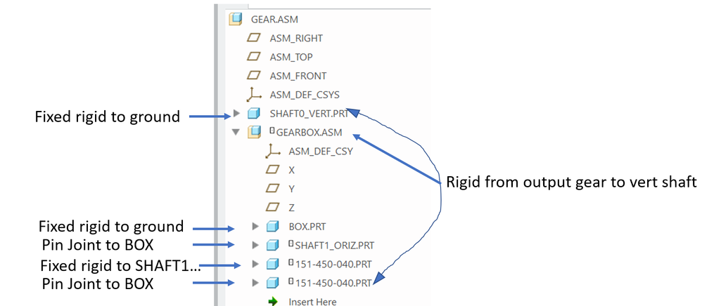

Yes, gfraulini found your simple issue with the gear ratio.  You should mark his as an answer so he gets credit.  I also attached updated model per my suggestion.  This is working with gearbox as the ground body in a sub-assembly until attaching the output to create the moving gearbox.  Your way is fine, but sometimes easier to model, evaluate, and understand the gearbox while it is stationary.  I will explain in case you do not have CREO 5.

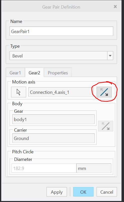

One last question, how do I reverse the direction of rotation of one of the two axes of the  gear motion? re-doing the assembly , it happened to me that the the orizonltal shaft  rotates  on its axis in the opposite direction to the one with which it should rotate, compared to the box .  It is very evident because gear attached to to the horizontal shaft  ,rotates with a direction opposite to its direction of advancement
Flip DirectionFlip Direction
perfect! thank you very much

i have not looked at your model but i have done the “stationary” gear thing before. i am not in my office so not able to look it up at the moment. my memory is that you should make a subassembly where the shaft rotates on a pin joint and define a gear connection. then assemble the subassembly to your “ground body” assembly with the moving shaft fixed in position. Basically this is how you make a gearbox rotate rather than the output shaft rotate. There are other ways to do this of course.
in short. make a gearbox subassembly with rotating output shaft. then rather than assembling the gearbox housing to ground assemble the output shaft to ground.
