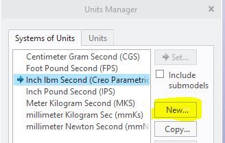

In the result window of Creo Simulate; the default unit is Pa. How can I set up the default unit to Mpa? Then, I don't have to modify the unit during the simulation or review. Is there a config option for unit modification?

Do you mean change the unit to mmNs in the model?
Is it possible to define the units to see the simulation results by modifying the setup configuration options?

You create a custom set of units with Mpa and then set your Assembly / Part to those units.
File -> Prepare -> Model Properties -> Units
