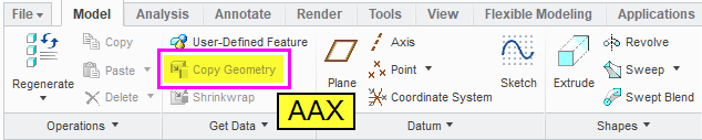

I copy the geometry into my FEM model, which has its own FEM template (asm and prt attached).
for example Creo Advanced Assembly Extension (AAX):
