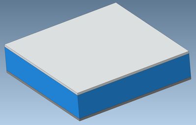

thanks for the quick response. I try to be a little more specific. I've made a little example to help me out with a few pictures. I have this model:

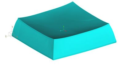

With this model I've mad some calculations and want to display them in die Solutions window. I want to see what the deformations would look like so im checking the deformed box. What I'm now able to display is this:

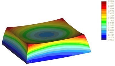

or this:
what I'm not able to show is a deformed model in which all the different parts still have their original color from the first screenshot. I hope this explains my problem a little bit better.
