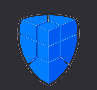

Use quilts to create volume regions. This view is the same all 3 XYZ sides of the center cube.
Trim and merge to look like this.

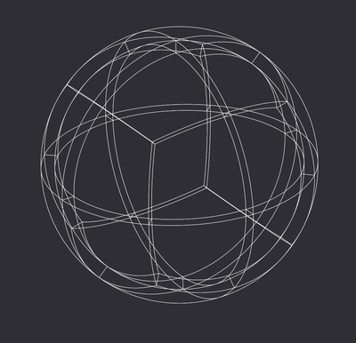

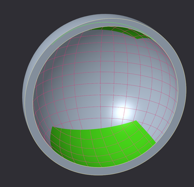

TIP: mapping does not work at the "poles" as seen by [Inspect] [Mesh surface] (shows U-V lines)
replace surface as shown (revolve around another axis then trim by surfaces like view 2 then patch)
confirm with [Inspect] [Mesh surface] .

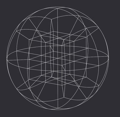

Create volume regions by quilt until this.
Section view showing internal volume lines.

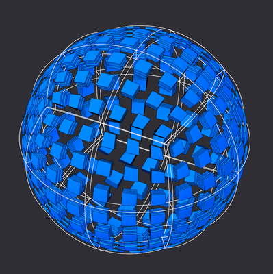

Map the normal way with bricks.
Tip: use RMB pick from list when it gets busy.
