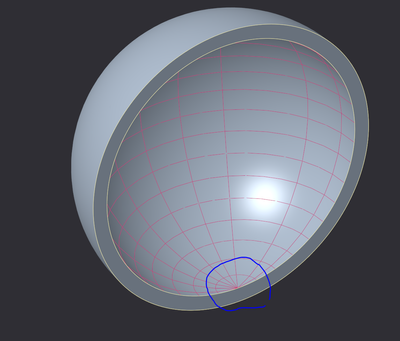

TIP: mapping does not work at the "poles" as seen by [Inspect] [Mesh surface] (shows U-V lines)
replace surface as shown (revolve around another axis then trim by surfaces like view 2 then patch)
confirm with [Inspect] [Mesh surface] .
