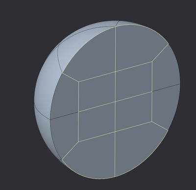

Use quilts to create volume regions.  This view is the same all 3 XYZ sides of the center cube.
Trim and merge to look like this.
TIP: mapping does not work at the "poles" as seen by [Inspect]  [Mesh surface]  (shows U-V lines)
replace surface as shown (revolve around another axis then trim by surfaces like view 2 then patch)
confirm with [Inspect]  [Mesh surface] .

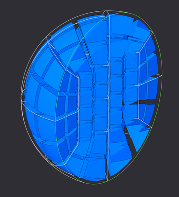

Create volume regions by quilt until this.
Section view showing internal volume lines.
Map the normal way with bricks.
Tip: use RMB pick from list when it gets busy.

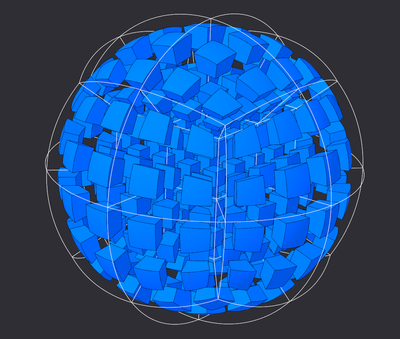

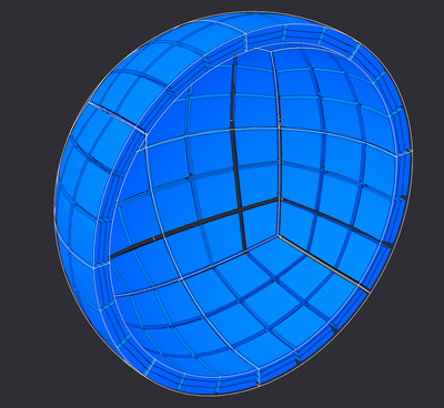

A hollow sphere proceeds exactly the same except the internal spherical surface must also have its U-V lines fixed.  (Center cube only for construction)
