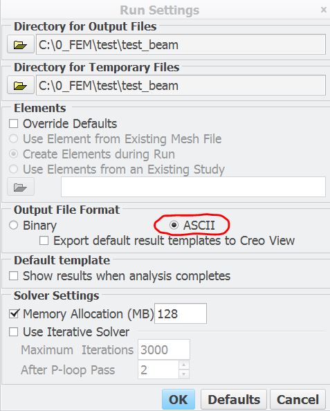

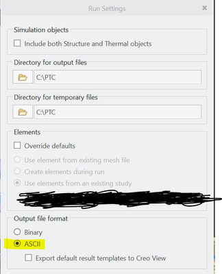

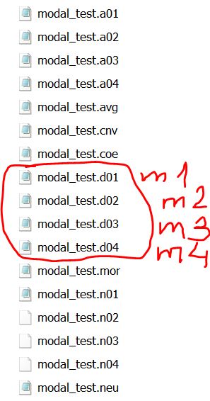

I did what you suggested and the files are here for each of the 12 modes I have requested from the simulation.
Now my question is about the results. The default result is a text file with 4 rows. Can you help me to interpret these results? What means each one of the rows?
See the reference document.
https://community.ptc.com/t5/Simulation/how-do-I-output-element-stresses-strains-in-tabular-format-in/td-p/386934
.d0x
h-node ID, vector(X, Y, Z)
Displacements doComputeMaxMag dontNormalize 7 7 0 -1.000000E+00 3.552309E+02
16182 8.994347E+01 3.461115E+01 -9.662632E-01
5572 9.172775E+01 3.529779E+01 -9.854165E-01
.neu
h-node ID, node location (X, Y, Z)
h-nodes 40025
16182 1.879850E+03 -1.320951E+03 1.601173E+03
0 0 0 0 0 0 0 0 0
5572 1.880184E+03 -1.321894E+03 1.598402E+03
0 0 0 0 0 0 0 0 0
