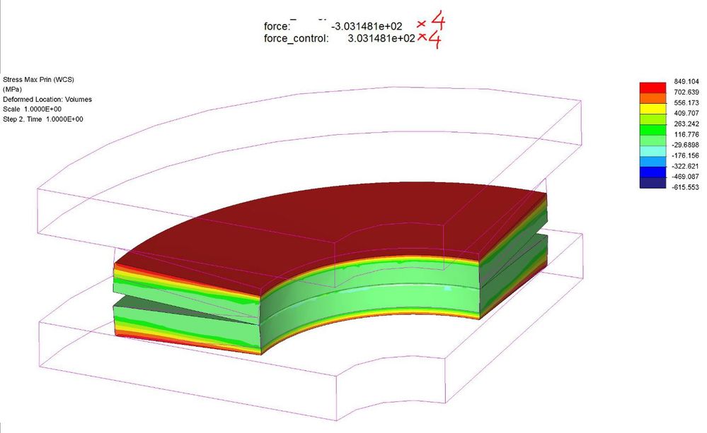

So how to connect the edges between every disc spring? I thank to use a "contact interfaces" but it Is not possibile with the edges..

litlle test attached

I Would like to know the reaction force obtained from displacement of 0,5 [mm], so What options I have to select? Thank you

measures "force" and "force_control"

Why "x 4"?
skunks
(To:fstopelli-2)
1/4 CAD-Geometry -> 1/4 Load
fstopelli-2
(To:skunks)
Yes, it's clear,
Thank you

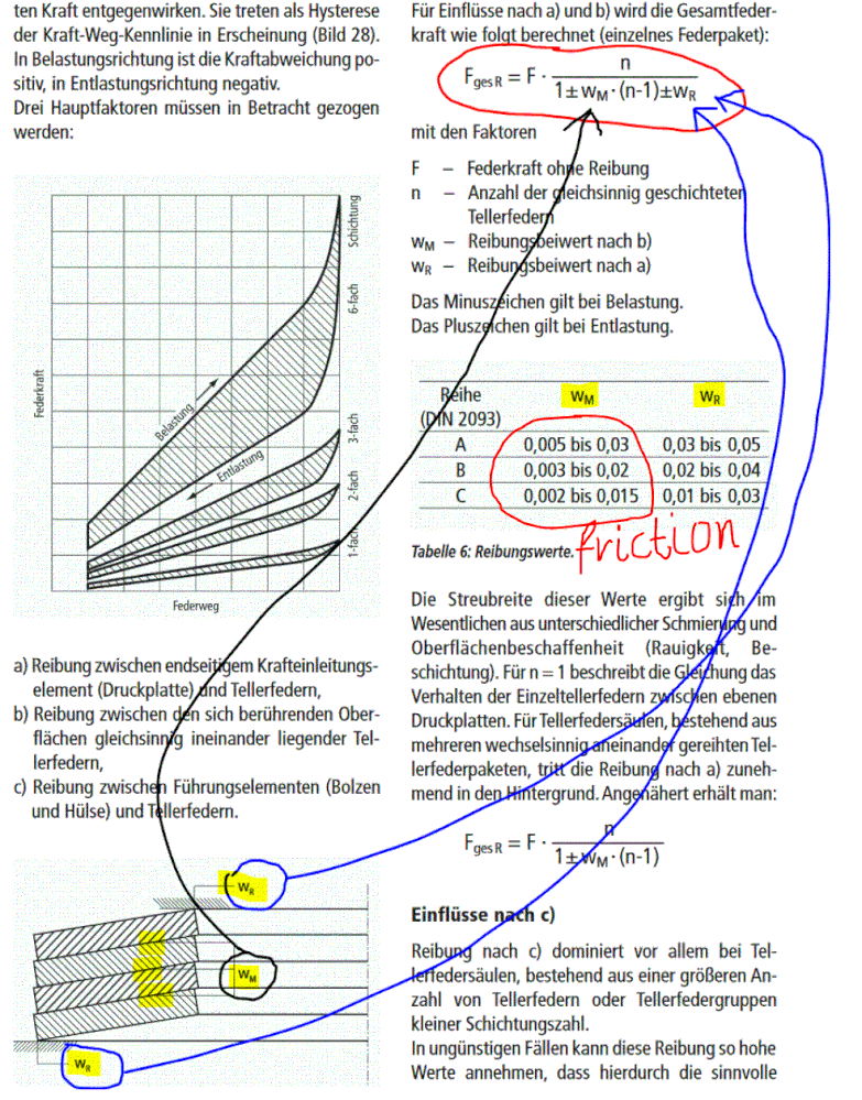

Those are shown in parallel... the OP wanted to analyse in series.
Nice reference though!
