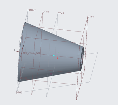

Hello! I was wondering about Creo’s capability to measure the Second Area Moment of Inertia (I). I am trying to calculate the second area moment for a common vascular needle, which has a cylindrical shaft and a conical tip. I was mostly wondering if Creo is able to find the second area moment over the varying geometry of the conical tip, or if it is only able to find one cross section at a time. I have attached a picture of what the needle end looks like below. I believe this process would require me to integrate by hand, as well as utilize the parallel axis theorem to connect the conical end of the needle to the cylindrical shaft. I thought Creo may have some functionality to do this within the program. Please let me know if I can clarify my problem in any way. It seems like Creo has lots of capabilities to find the mass properties of different parts, but since I need the area moment of inertia the mass properties are not required and instead geometry is my biggest concern.

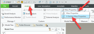

StephenW
(To:Adam_McGoff)
Under the analysis tab, Mass Properties has a drop down that lets you select x-section mass properties and will generate the area moment of inertia.

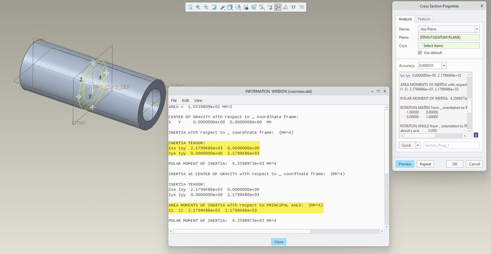

I now understand.
My suggestion above to use BMX is still valid to automate this process. Use a field point on the bias cut and the central axis to move the section plane along the central axis and plot the results. If you do not have the BMX module, then you can do this manually by plotting the results from each cross section. You will not need too many points to get an accurate curve in this case.
Creo will report the value for I at any arbitrary section. The measure of interest is found as @StephenW has already mentioned. Within the results the inertia tensors are presented as shown below. You should do manual calculations for verification but generally Creo should be very accurate on these results.
Derived tensor for area moment of inertia of an annulus wrt to centroid:

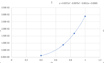

Adam_McGoff
(To:tbraxton)
I began plotting the moments of inertia along the conical end of the needle. It looks like when plotting these points there is a polynomial distribution along the needle tip (a picture of the part and the I-value distributions are shown below). Would finding the area under this curve yield the estimated area moment of inertia for the entire part? I just wanted to make sure I clarified that I have been interpreting the data properly. I appreciate all your help!

Adam_McGoff
(To:tbraxton)
I just need the area moment of inertia over the entire body so that I can use Euler's equations to find the buckling force. However, I believe finding the area under this graph should suffice for this right?
