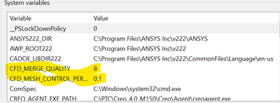

What are your settings for mesh size? You might try to make these settings smaller since you have a very thin part. The following image shows the default settings.
Try these settings
Maximum Cell Size: 0.001
Minimum Cell Size: 0.0001
Cell Size on Surfaces: 0.005
There are also a couple of system variable that might be missing or set to a better value.
CFD_MESH_CONTROL_PERCENT = 0.1
CFD_MERGE_QUALITY = 8

My settings are the same for everything except merge quality which is set to 10. I shortened the heating cylinder slightly so that it's no longer in contact with the base and now the base is getting meshed correctly, but the element isn't. I'll try increasing the thickness and see if that works. I isolated just that part and the insulator around it and started meshing it; it took an incredibly long time to complete the mesh, though. It's hit around 138 million splits and took probably 30-45 minutes. When it's in the full assembly it takes around 10 minutes or less to complete the mesh. I'm guessing that, because the isolated assembly has much less complex geometry, the cells can be much smaller for the simpler geometry and the meshing tries to normalize (or keep relative size) cell size to the largest cell generated. Is that's what happening?
