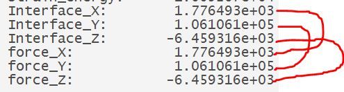

I want to try to extrapolate force (tension) from a welded structure to perform a calculus as prescribed by EN1993-1-8.
I want obtained the forces by measures of a simple truss loaded by transversally.
On each side of the green beam I want to simulate the presence of two filled weld with a=5mm.
I used two kind of measure: Force and Interface.
Looking on the Help it seems the proper one should be the force measure, but, in this case, I think both should be right.
Exept that the results are different, so which are the right?

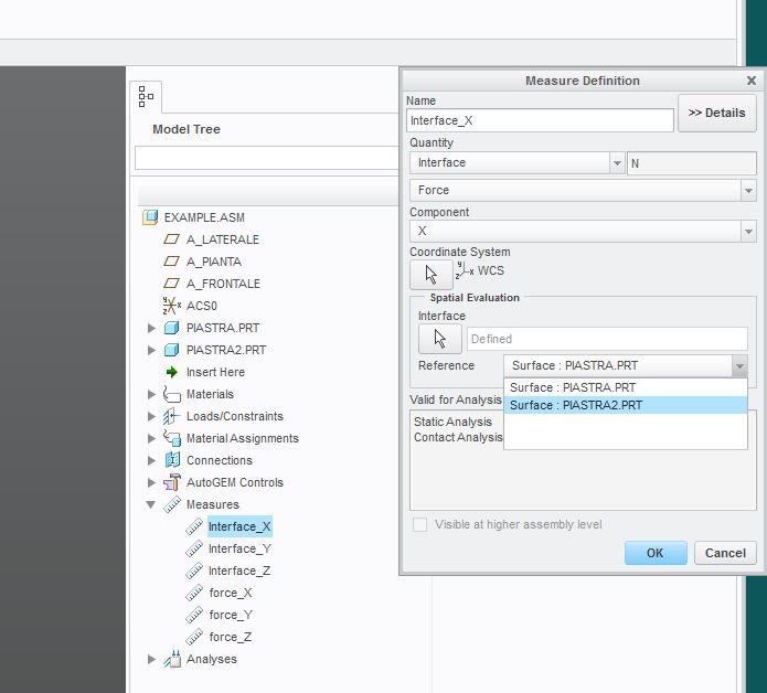

So what you've done is to change the reference in the interface measure definition.
Yeah, I had not seen this option in the measure.
But at least now it all adds up with my initial idea reasoning that the two measure must be egual.
