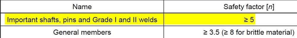

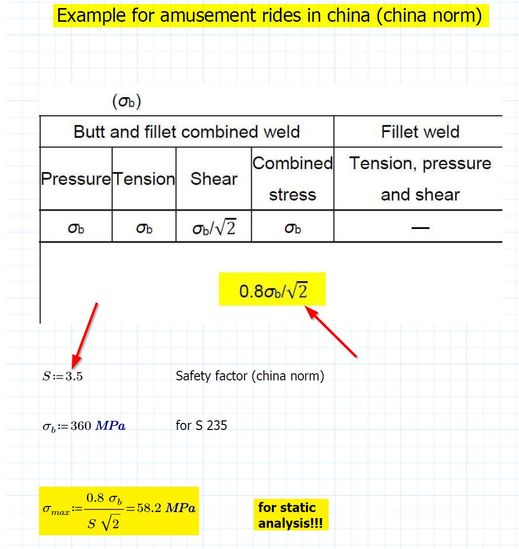

I believe we have a similar issue in many requirements / industries where higher safety factors were used to account for the real stress vs the stress found by simple hand calculations.  For example do we still need 8X safety factor when we have calculated the stress 3X higher than hand calc. because of more accuracy with FEM?  We still have so much in our modern world still based on empirical data "recipies", making the switch to FEM extra difficult when such things have been written into laws and regulations!
yes, ec3 is very conservative..
but a most problems i have in CN:
sometimes
safety factor is 5 !!!
