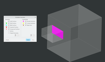

Bonded elements are joined by sharing faces, just like elements not at an interface are connected to each other. This makes meshing more difficult because of the continuity required. Another term for this would be equivalence. The bonded faces and nodes are equivalenced. If the materials were the same on either side of the bond, essentially the interface could not be seen at all by the solver, and would look like one continuous component.

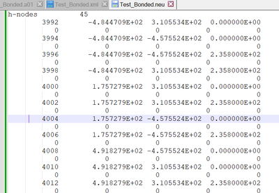

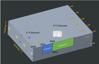

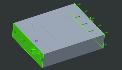

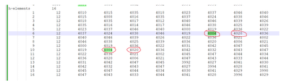

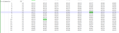

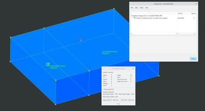

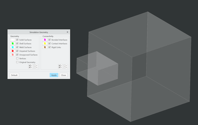

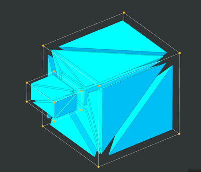

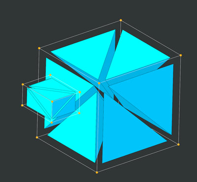

This is not the whole story, but the plotting h-elements share nodes across the bonded connection. (see Part 1) Bonded connection is not a TIE contact connection like traditional code. TIE would use constraint equations. In Hypermesh bonding is equivalent to imprinting elements to be the same on both matching bonded surfaces, then equivalencing the nodes. In Part 2 notice how the mesh changes for the bonded vs the free interface. Contact and Free interfaces will not enforce mesh equivalence.
PART 1
SweetPeasHub_0-1690817631122.pngSweetPeasHub_1-1690817699856.pngSweetPeasHub_2-1690817744988.pngSweetPeasHub_3-1690817866895.pngSweetPeasHub_4-1690818129425.png
PART 2
