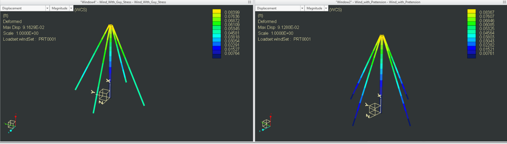

I am using Creo Simulate (version 7) to perform the following FEA study. I need to idealize four Guy wires within the genset exhaust and silencer assembly that will help stabilize the chimney when high wind loads might be experienced. The four Guy wires are meant to be attached to the frame which is supposed to be mounted onto the flange of the top most part of the chimney as shown in the pictures attached.
I have tried single and multiple beam elements till now but both of them behave unnaturally. I have used a rigid connection at the top for connecting frame and the beam elements and have used fixed translation free rotation for all at the bottom point (ground) of the beam. Please see attached some of the pictures that will help communicate better.
For the single beam element, when wind loading is experienced, two ropes must be in tension like state while the opposite two must behave different to these. However, all four more or less seem to behave the same? Also the behavior of these ropes at a scaling factor 1 (actual deformation) does not seem to be natural as the ropes could be seen sagging towards the ground. Would that be because of the own weight of the ropes? Because the solver has been specified with own load of the assembly to be taken into consideration as well along with the wind loads.

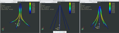

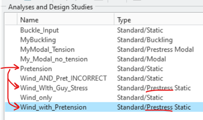

The step @YT_4948  is missing is using prestress analysis. The standard linear analysis uses superposition so the sag of the guys due to gravity does not account for pretension - it is done independently. I have attached a complete example for a tower with guy wires modelled as beam elements that includes the incorrect and the correct prestress techniques for the static and the modal cases. Also an example for the buckling case is included but you would need to suppress the beams for that example. This is Creo 10 so hopefully you can upgrade to see it.
FYI this is a similar technique as that used for stringed musical instruments.
Wind and Gravity    + Pretension        =    WRONG ANSWER
Run pretension first, and then Prestress static and you get correct results.
First/LH case below has the check box to include the results from the pretension run.
The increase and decrease in tension in the wires due to the wind load are also correct and there is no exaggerated sag due to gravity.
I believe if solid elements were used, a non-linear analysis would provide correct final results without the need for a pretension analysis step. Also, with non-linear analysis you can time-stagger the loads, accomplishing the pretension in another way.

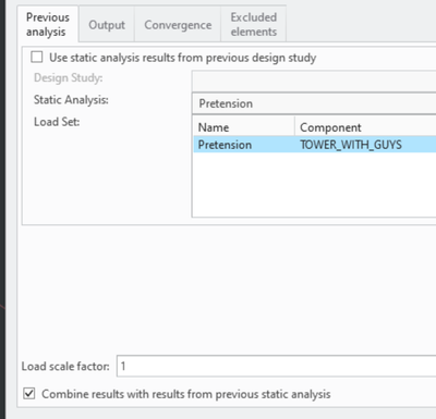

I am a little confused if I must tick this red circled box or not in the attached snip. I could see we have ticked "combine results with results from previous static analysis" though. Should that help as it is or do we still tick the top box circled in red and then proceed? Please guide.
Good question, as the circled box can be confusing.
Unchecked - The prestress study is run first as part of the prestress-static and both result are available under the same single study folder structure.
Checked- Means you have already run the prestress study and have a result folder so you are asking to not rerun that study but to continue onward with the 2nd part of the prestress-static study. This does a check to make sure the model is the same and will not run successfully if it detects changes. I find on occasion Creo detects a change when there was not any change. (probably related to geometry problems / approximations)
I prefer unchecked because if I change the model I need to rerun both studies anyway. It is more for saving that analysis time for rerunning the prestress study that the checked option is there. However, if you have multiple Prestress-Static scenarios that all use the same input prestress study by checking the box they could all refer to a single prestress run rather than each running them as part of their own study.

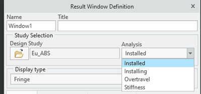

For running multiple studies as part of single study this is the option._1
This would be for a larger sequence of studies that you want to collect together for example based on a specific design variant. (Run modal, several static, buckling, etc as one study called "MyDesign1")
when results are pulled for the study, there will be multiple analysis to pick results from.

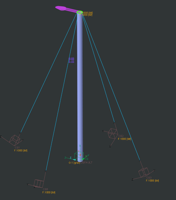

Hello @SweetPeasHub , I have been trying the above mentioned way of simulating the real life scenario where I run the prestress studies first and then prestress static including the own weight as well as the wind loading and it seems to be running much better now. However, I have still got a doubt about the constraints - According to the real life scenario, we will have an anchor fixed to the ground and a shackle fixed up at the frame to which both the points of the Guy wire will be connected to. So, aren't they supposed to have pinned constraints at both the ends while performing the FEA? If so, how do we simulate the prestress at the bottom now if there is a pin constraint there? Please see attached pictures for your reference and kindly guide.

I use temperature loads for prestressing.
example att.
