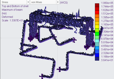

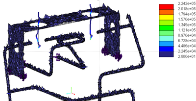

See above screenshot, the spikes of stress calculations among shell elements. Does anyone see this before?! The stresses should be less than 20ksi, however, these spikes are around 2.0e+7 ksi. I am using Simulate 6.

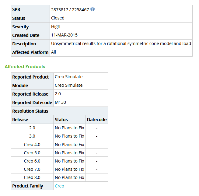

Disclaimer: I don't have maintenance, so I can't track if the SPR 2258467 has been closed.  I have to say that it seems to me that PTC has gotten better lately, so I'd be curious if there was a resolution to a very basic issue that somehow got past PTC QA and made it to a released product costing $$$

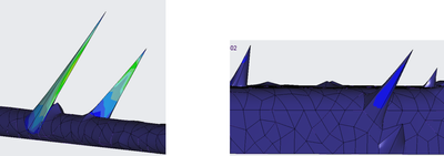

Please give us more information. If you can attach a zip file that would help greatly. My only comment on the images is that the elements look strangely shaped.
The image on the left side shows the shell elements of a metal bracket of thickness 0.1". The image on the right side shows the von Mises stress distribution in the latest simulation just now. There is no more "spikes" shown in yesterday's post.
It never happened before according to my limited memory.
On yesterday afternoon, when the "spikes" showed up, Simulate popped up a message "Fatal error encountered", then quitted.
Today, this is no error message.
The traceback.log about yesterday's incidence is attached here.

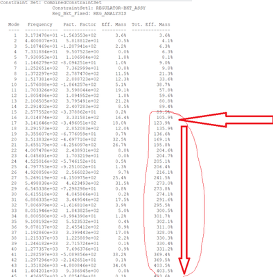

Simulate allowed the Total Effective Mass to be greater than 100%!??
NEVER HAPPENED BEFORE! Numerical errors in 1-sigma von Mises (ksi) calculations are absurd!
Total Effective Mass should be approaching 100%, not 351,854%! Creo Simulate should not allow this happen.

Can the mesh (nodes /element ) and the data in the result (file) be for a different mesh? I have seen such issue in some tools as long as there is a node with say the same id then the tool will try to plot something. Is the plot for disp & rms stress ? looks like simulate is plotting rms disp hence the "spikes". You pointed to total MEFFMASS > 100% in another post so clearly something's not right
JS_9824412
(To:JXBWk)
The plot is for rms stress.
This is caused by some software bug. Because it can work sometimes, i.e., without changing anything, sometimes Simulate can produce normal results, at some other time it can't.

Well, if you want accurate results, then ANSYS might be the way to go.  By the outcome of the SPR 2258467, it seems that PTC feels that they would spend too much effort on fixing Creo Simulate and since it gives "almost right" answers most of the time, that is good enough.
I would not be surprised if there is no one left at PTC (be it product manager, software developer, mathematician) that knows about this closed issue.  And since it was filed away under Creo Elements Direct - Drafting (???), most FEA users won't come to know that they are using sub-standard solution.

So what do you think of that whole SPR 2258467 affair chronicled in the thread Non-symmetric results for symmetric model and load? ?
I guess I still can't get over how PTC handled this, despite clear demonstration of the issue and how other software (Solidworks, Abaqus) didn't require any "mesh refinement" mentioned as a work-around.  Also, it seemed that some knowledgeable users pointed out the root cause.  Yet PTC didn't seem to fix it.  My impression: they don't care enough, or they can't.  Either way, kills my confidence.  It's like using a spreadsheet application and accepting that, with value in cell A1 = 2.000 and one in A2 = 2.000, then formula "=A1+A2" in cell B1 will, in some cases, display 4.010
