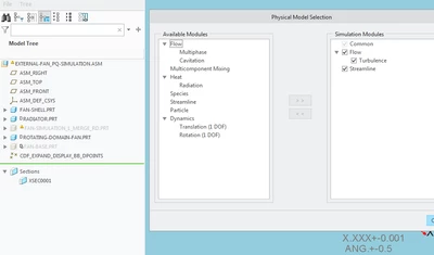

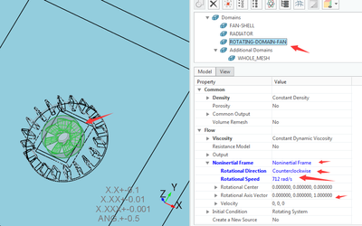

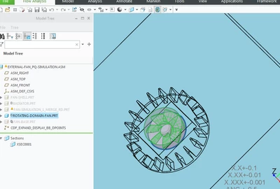

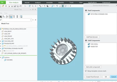

Does someone have some experiences on seting up a fan in the simulation? now we know the some Parameters of a fan,such as RPM ,P-Q curve etc.How do I load the Parameters into the software?The following pictures , that I will show the steps,First,create fluid domain(create the fan rotation domain)

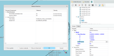

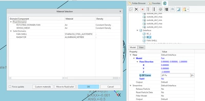

Second,select the soild components and the fluid components as the picture
Third,select the physical model

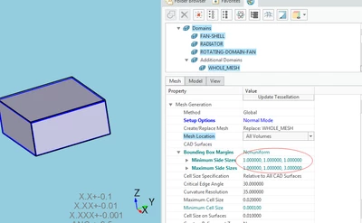

Fourth,select all the domain,and mesh location Options selected "All Volumes" the others setting as the pic

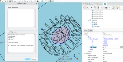

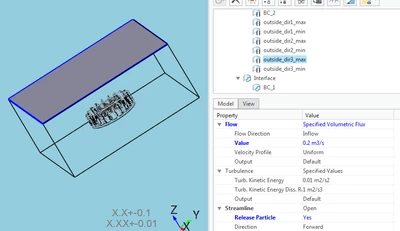

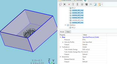

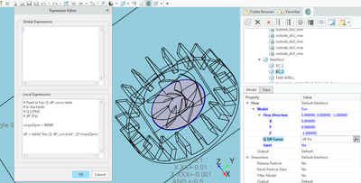

Fifth,set up the parameters of a fan&boundary conditions,see the pics

Please refer to the following help page about how to use a fan curve. Also we can model the whole fan using MRF or moving mesh too. Thanks.
