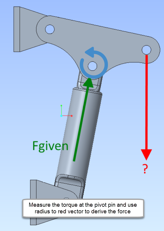

is it possible to measure the lever force over time in Mechnism dynamics?
I have a simple lever mounted in the middle. On one side it is moved with a hydraulic cylinder.I know the displacement and the force in the cylinder. I would like to define these parameters. The vertical force that acts on the other side of the lever, I would like to show over the cylinder length or the time.

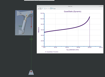

Use a large damper to make the simulation quasi-static.
This is a solution for finding a series of static balance forces along a change in configuration for any mechanism.
To do this you need to use a quasi-static style of analysis. If you add a large damper as shown with long simulation time duration so inertia effects are negligible, you can get the force out vs cylinder extension. This is still a dynamic analysis requiring mechanism dynamics extension.
A constant force motor was applied at the cylinder and the net load measured at the damper.
If concerned that the damper force is not pure Y direction, you could also reverse those and have a constant downward force at the output and the damper at the cylinder.  Or you could just send the bottom attachment of the damper down significantly in Y.
This seems simple enough but I believe this is a better answer to several similar questions in the community and it just popped into my mind today and I thought how dumb I was not to think of this yet!  😀  Thanks for reviving this question! I have Creo 10 models if you like a model.

MA_9965308
(To:tbraxton)
sorry,
I should have attached a picture at the beginning.
Now I got one. I want to define the green cylinder force and measure the vertical red lever force. The cylinder has a stroke of 200 mm.  I want to display the lever force over the time or over the stroke.
I want to know how much I can lift in each position. On a paper, this is not a problem with this simplified design. But in Creo I don't know how to do it yet.
Is it now understandable?
Greeting
Morian
tbraxton
22-Sapphire I
(To:MA_9965308)
One option is to measure the torque at the pivot pin joint where force motor is applied. This will enable the derivation of the force at the location you want to solve for.
