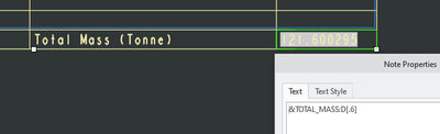

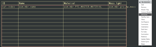

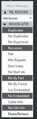

Parts do not need to be solid to have mass, they can also have ASSIGNED mass such as for example bulk items like grease. Since it is simple addition, I am reading in between the lines that there is something about the mass reported that does not seem correct and you want to investigate. I would look into making a drawing with a repeat region reporting the mass and material for the assembly. I do not remember if Creo7 has options for the repeat region to recursively expand all subassemblies but up-to-date Creo can. These screenshots should get you on your way to making a drawing table for this. It is generic so be sure to save the table for later use so it can be used as "table from file". The exact keywords changed recently so you may need to look up the correct key words for the repeat region. Once you have this table it is much quicker to identify incorrect masses and it can be saved to Excel.  (At least in Creo 11)
