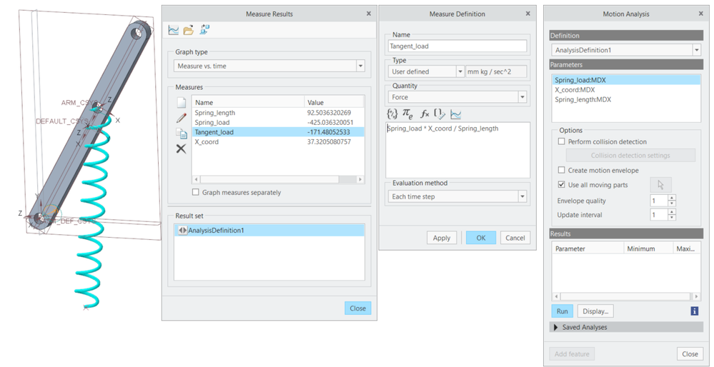

Hi, everyone. Here's hoping someone recognizes this problem.
I have a simple assembly with an arm and a spring. I want to make a motion study measuring the force from the spring in the tangential direction that the arm is moving. To do this, I've set up some measures for the force of the spring, as well as some position measures that allow me to calculate the force component in the relevant direction. I've then set up a user-defined measure that looks like this:
Spring_load * X_coord / Spring_length
The Spring_loas measure is a Net Load measure for the spring. The X_coord and Spring_length measures are position measures.
So far so good. I can run a Dynamic Analysis and calculate my measure. I can pull up a graph and see how it behaves over the analysis time. But now I want to do an optimization study for this. To do this, I create a Motion Analysis. Now, in the area where I get to select my parameters, all the direct measures (Spring_load, X_coord and Spring_length) are there, but not my user-defined measure. What's even weirder, some troubleshooting shows me that if I remake my calculation to this:
... I get to include it in my motion analysis. But as soon as I add the Spring_load measure in my calculation, it disappears from my motion study options. I'm able to use a derived measure based on position measures, but as soon as I add the spring force into the calculation, it can no longer be included in my analysis. Anyone have any idea of what's going on here?

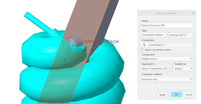

2. add a dummy pin part where the spring connects.  Get the connection reaction for the pin joint referenced to the moving arm. I prefer this because it is more directly obtaining what you want and will not have the bug that user defined measures can have.

Thanks for your answer. Yes, I have set a unit, as you can see in the screenshot. I've tried setting it to both Force and Dimensionless, but it doesn't help. And the problem isn't that it's user-defined, since it works just fine if I remove the Spring_load from the calculation. As long as I work with just position measures it's fine, but when I add the net load measure, it's not available anymore. I's really weird.
For the moment, I managed to make a workaround since a spring force is so easy to calculate. I basically made my own Relation Analysis calculating the spring force and used that in my Motion Analysis, but that's not that elegant, and only works with such a simple thing as a spring. For other types of studies, that obviously wouldn't be an option, so I'm still hoping to figure out the issue here.

I've done some test and I'm not be able to utilize the "tangent_load" for optimization/feasibility study.
Even by specifying a relation with data taken from motion analysis
  • max_sping_load
  • max_x_coord
  • min_spring_length
I can't utilize it for the optimization.
It appears you can use only dimensions/parameters/measures directly created by Creo

Thanks for having a look. As I wrote above, I manage to get access to the user-defined measure in my motion study as long as I don't include the spring_load measure in the calculations. It's really weird. The issue is with getting the user-defined measure into the motion analysis. I have no problems running the optimization study.
I can run studies for optimizing calculated parameters without problems. Uploading the model I used in the end. This doesn't use the spring in mechanism, though, but rather calculates the spring load through a relation. But I can run an optimization study trying to minimize the spring force difference (DF:Tangent_force_diff) while keeping the tangent force (F:Tangent_force) to (for example) 10 N. And the tangent force difference is calculated in a relation analysis feature.

Yes, there's something weird. I received an e-mail with your answer and marked it as a solution there, but couldn't see the actual reply in the thread. You were on the money: deleting the measure and recreating it made it work for me. Seems like there's a bug with user-defined measures being redefined. Does anyone know if PTC has been made aware of this issue?
The solution with putting a dummy pin is a good one, too. I thought it annoying that I couldn't measure reaction forces at the mounting point of the spring, but I didn't think of making a small pin and attaching the spring to that. Thanks for that idea!
