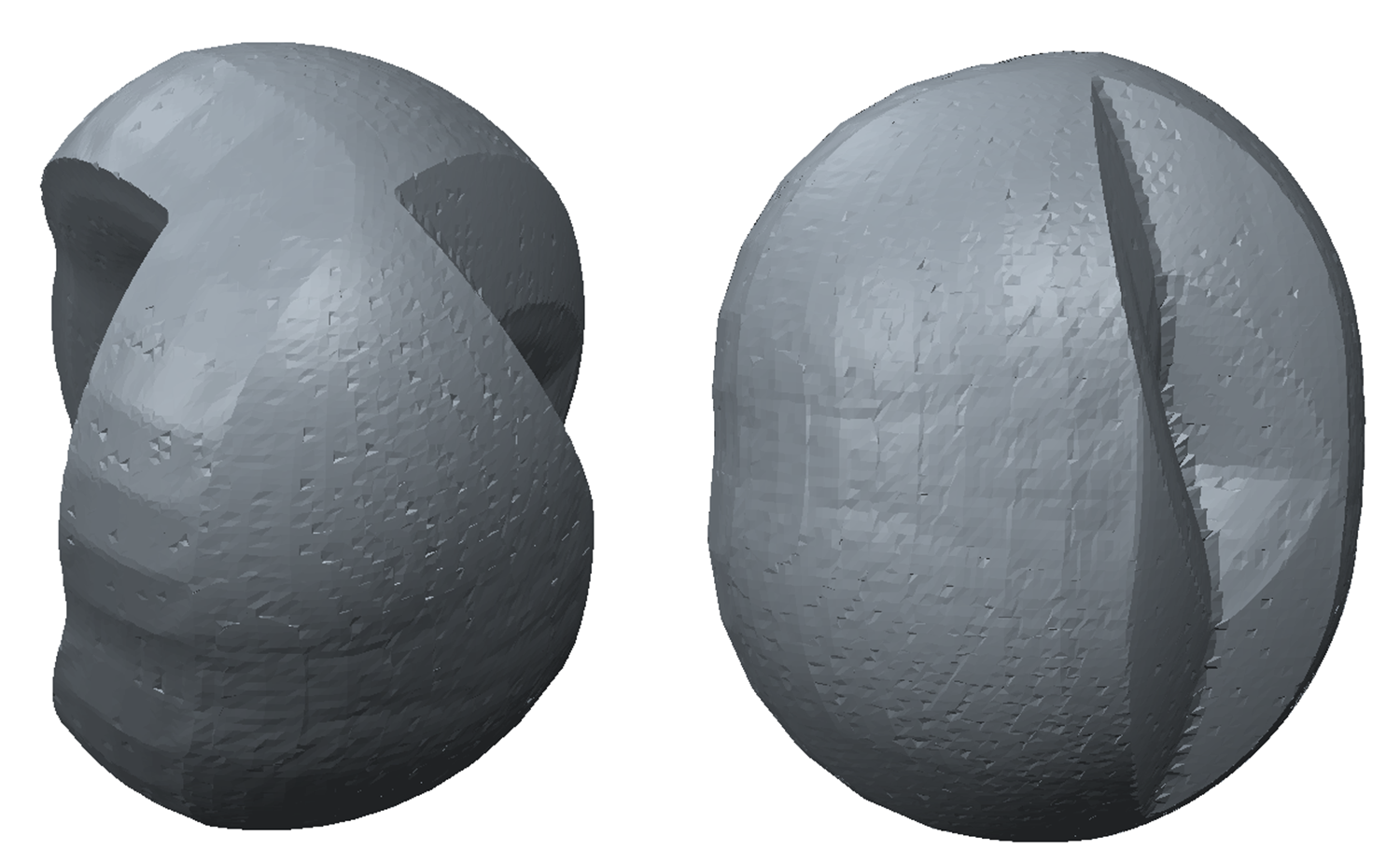

What I started with (shade=3, edge=medium, frame rate=10, envelope quality=10):

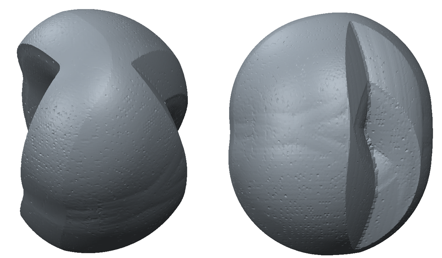

What I have now (shade=10, edge=very high, frame rate=100, envelope quality=10):

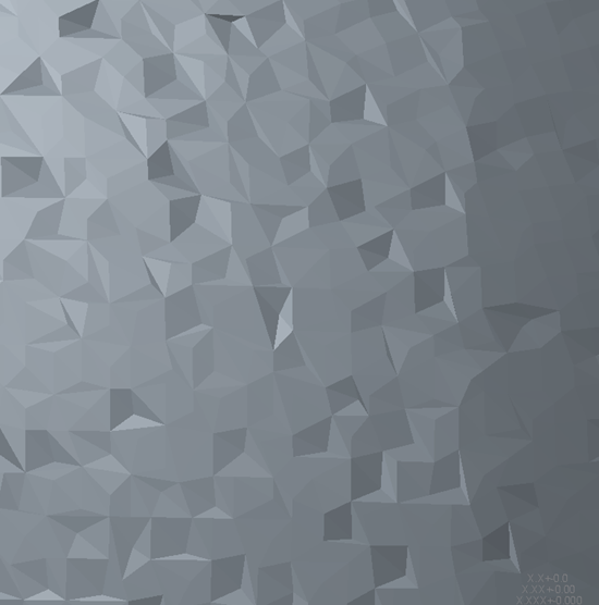

A big improvement, but the mesh still has jagged elements that I would like to smooth out:
Does anyone know if there are some other options I can tweak or tools I can use in Creo 2 to create a smooth mesh? I imagine there's a smoothing function in the surfacing or reverse engineering applications, but I don't have access to them.
