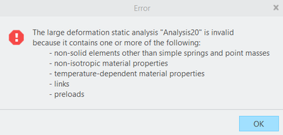

I am getting the below error when I am trying to use non linear option
skunks
(To:NR_10501208)
yes, large deformation analysis is non-linear.
some non-linear options cannot be combined
Can't the model run with shell elements? I removed shell and made it solid then model is running.
