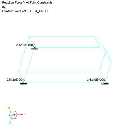

Whenever I print to pdf, the point constraints result plot lose part of its resolution, making them close to unreadable. Is there a way to increase the font size of those particular fonts bigger?

my workaround in creo simulate 2: screenshot

I am using Creo 10. I have swapped one of the point constraints for one "spring to ground". How do you manage to now see that spring force / ground reaction in the result window? Only way I can find that value is by using a measurement.

--> Creo data as an example
