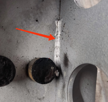

Interrupted weld seams are not permitted for dynamic loads:
