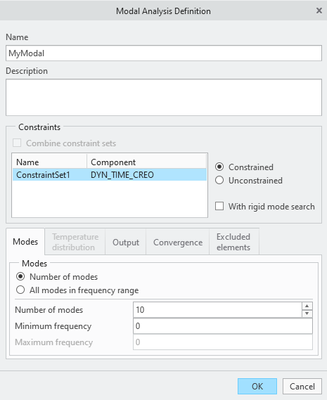

1. Define a modal analysis
a) constrain the model (unless doing free-free study)
b) set number of modes or frequency range. For dynamic time I suggest at least the first 10 modes.

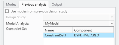

3. Define a Dynamic Time analysis
a) reference the previously defined modal analysis (can choose to run on demand or a pre-run study)

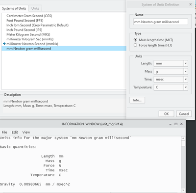

thank you for the steps it really helped. i am just not able to plot acceleration VS time plot of the results, please guide me through that. in addition to this I just wanted to confirm that the units of the time steps that are being displayed are in seconds right?
The time unit is by your unit system for which all of the built-in units are in seconds.
But, a custom unit system could be made, for example the common millisecond time base for dynamic analysis.
