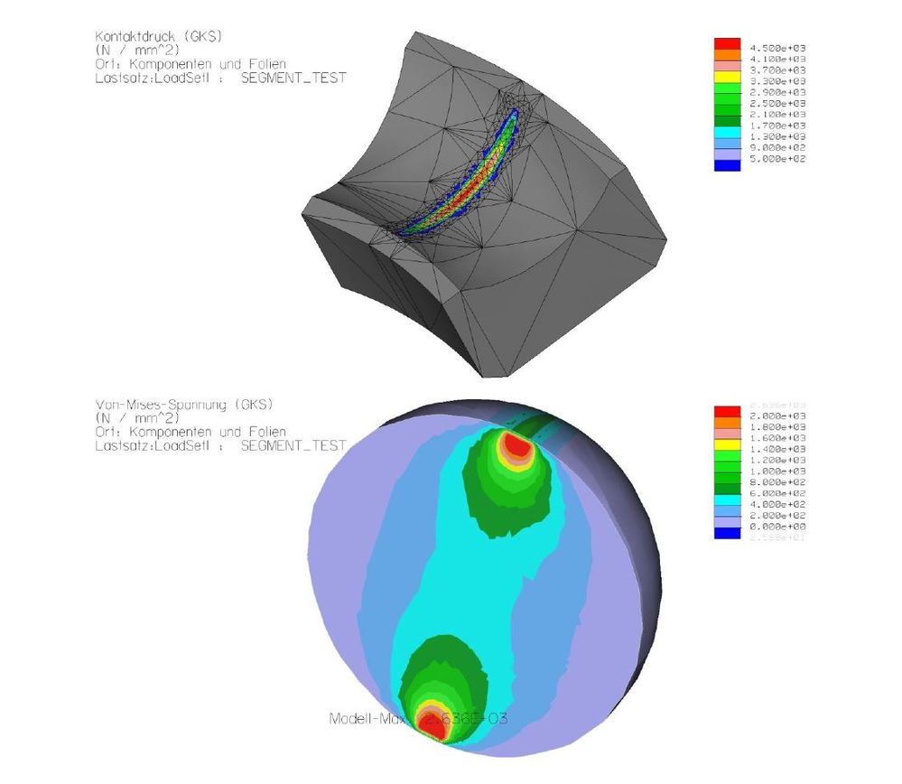

I am working in which two bodies are in a contact with each other. There is a concept called hertzian pressure which says that maximum stress is inside the surface just below the contact and not on the surface or point of contact. I have attached an image which would make my point clear.
Is there any way to see or to define a section view in the simulation result window?
Yes, ever since Simulate exists it is called "Capping or Cutting surface" (I don't remember how it was called in Structure for Wildfire releases) and it has the same icon as the Section in modeling environment.
