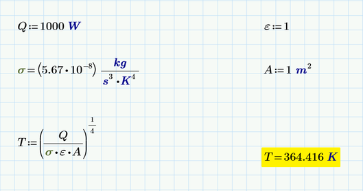

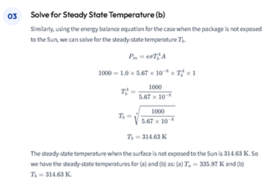

OMG! I freaking got the answer out of a physics book solved problem (to test my ability to set-up the problem in Creo). I can’t check now but if they did their math wrong it’ll blow my mind. I will look shortly but I’m willing to accept you got it right for now. Thanks so much because I was completely bamboozled how Creo would get that wrong.
Once I’ve confirmed I’ll go on the site again and reply and confirm you got it right.
Thank you.
So check out this screenshot from the text book. Who’d o’ thunk their math was wrong?! But I used MathCAD as well and got the same answer you did. Wow. Thanks. Mystery solved.
