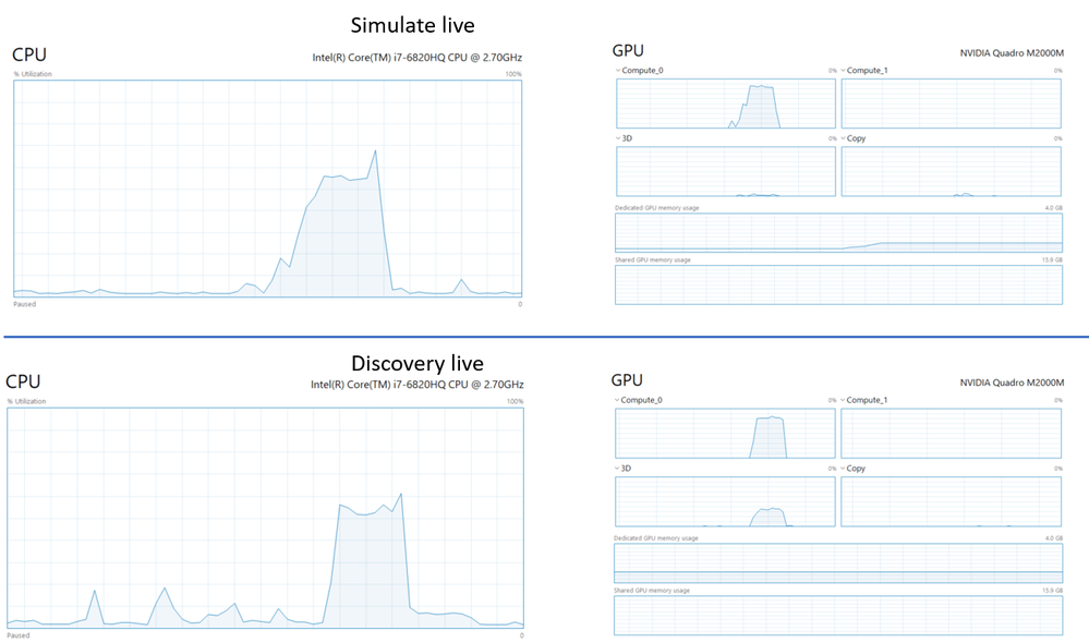

I have one more question:
When I click Start Simulate live, I do see a spike in CPU usage. (See the picture below).
Why is that? Is CPU used for showing/animating results on screen?
Domen
Hi @Domen,
I have reviewed the system utilization while running Creo Simulation Live and have noticed the usage of the CPU along with GPU.
As stated prior, the solver for Creo Simulation Live, for that matter Ansys Discovery Live, are performed on the GPU.  This requires a dedicated NVIDIA graphics card that is CUDA enabled and having a minimum of 4 GB of RAM.   Creo Simulation Live does use the CPU for performing certain operations, mainly for animating the deformation of the model.
Performing a few tests, we see the CPU is being utilized and spikes during the simulation as soon as I start the animation of deformation and drops when I stop.  Comparing  Creo Simulation Live and Ansys Discovery Live, we are seeing similar GPU and CPU utilization.
The main resource for Creo Simulation Live is the GPU.   While it does utilize the CPU for certain operations, this will have little impact on the system.
