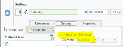

On a slightly different note, any idea why this would be grayed out?
