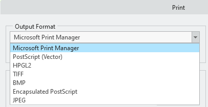

There is ... its just not in an obvious place. PTC decided to bury it in the print menu.
File -> Print -> change printer to image format you want.
Article: CS250046
